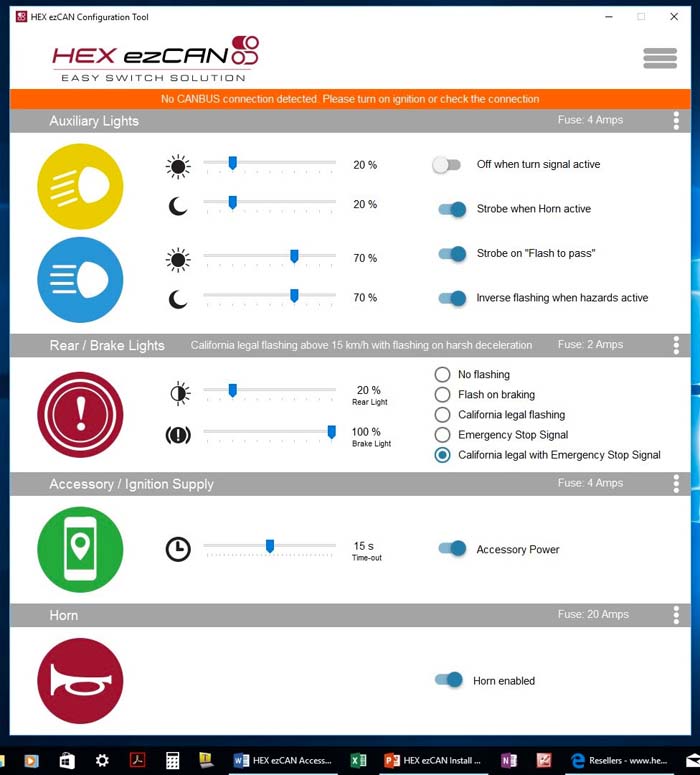

Quote:
Originally Posted by TouringTim View Post
If you read the denali website it clearly says:
The CANsmart's four circuits are preprogrammed to connect and independently control two sets of DENALI 2.0 lights, a SoundBomb horn, and our B6 auxiliary brake light. However, our clever "Simple Circuit Over-Ride" feature will let you run any accessory of your choice on any of the four circuits
When you read the manual this is a windows application that can be used to reprogramme each circuit via USB. If this is true then Garage Opener / Closer is no problem.
You've misunderstood what this does. I've been a beta tester for the Hex ezCAN and am quite familiar with what it does and and does not do. This is the exact same thing relabeled for Denali. That accessory circuit is a constant power circuit. It comes on when the bike comes on. When you set a channel for accessory use, the only thing about that channel that you can program is how long is stays on after the bike is turned off. It isn't programmable in the sense that you can trigger it by some designated pattern of button presses.
Take a look at the screenshots of the two units' software:
It is pretty apparent these are the same thing. The only difference is the Denali has a slight difference in how they present the option of how one of the channels can be used for accessories.
