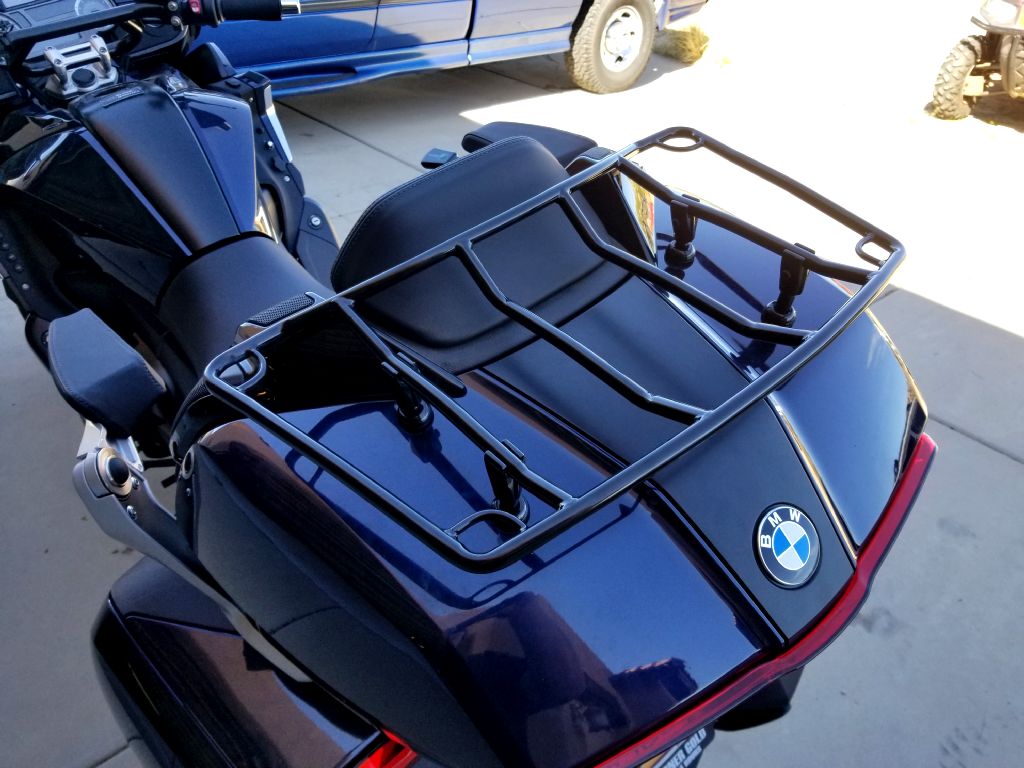

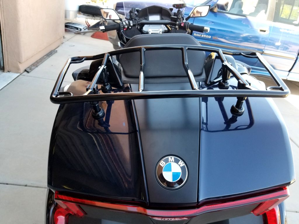

My favorite is the Kuryakin #7149 Trunk Rack.
https://www.kuryakyn.com/products/4336/multi-rack-adjustable-trunk-luggage-rack
I have rarely been so pleased with an accessory. This trunk rack is one of the best products I've had the pleasure to install. The super adjustable mounting system with the ball and socket is so easily adjusted, it makes installing the rack a snap. I bought the black one for the K1600BGA and it looks absolutely great and looks like it was custom made for it. Makes the Wunderlich rack look like cheap junk. Plus, halleluia, it has rings for holding bungie cords. What a concept, but Wunderlich couldn't figure that one out.
I can provide drilling instructions if interested.

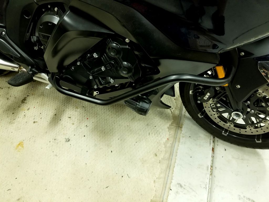

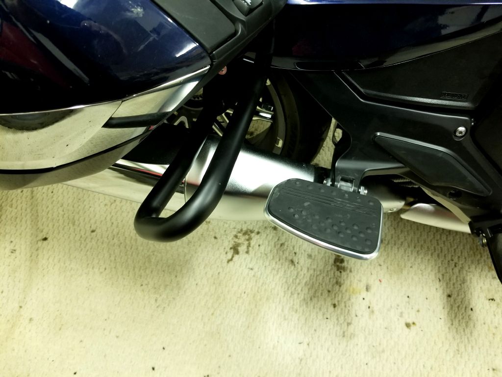

Wunderlich Engine Guard Bars for B and GA. So, bit of a story on this one. You may note in the pix, that I don't have the floorboards but do have the fairing storage pockets. Which by the way, my dealer messed up the bike order and it came with the floorboards. I changed out the floorboards for side pockets myself.
Also, I really like G-pegs. They are the greatest highway peg for K1600. Way more comfortable than they might look and they also fold up completely out of the way when the world gets twisty.
So, it turns out that the stock engine guards, which are under the floorboards aren't compatible with the G-peg mounting. And the old style engine guards which are compatible with G-pegs, aren't compatible with the new design of the fairing.
When I saw these engine guards in the catalog, it looked like they would work with the G-pegs and they do.
Warning, this is a typical Wunderlich product. That means that the instructions are cryptic at best, no diagrams of how to mount, only low res photos that you might be able to decipher. And BTW, its not a German to English problem either, the German instructions are identical. The fit is very fussy and took some extra washers to take up some space where the fit wasn't right.
I also don't hate the look, but not in love either. The do look like they will protect the side plastic in a tip over, so points for that.
Overall, if you really love G-pegs, this is the only way to go. Otherwise, look elsewhere.

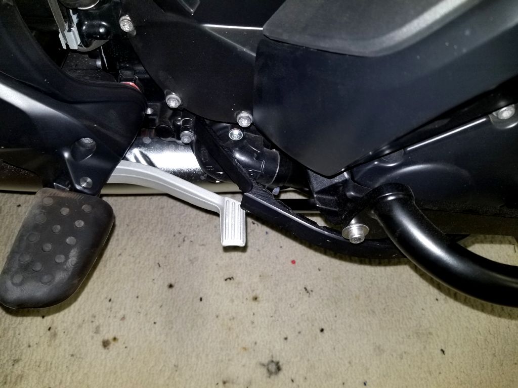

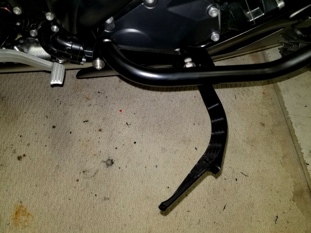

G-peg extended. That curved shape looks odd, but after 800 miles or so, your legs will appreciate it.
G-peg retracted. Completely out of the way and won't drag in a corner like Ilium pegs. The do tuck up over the foot levers, so big chunky Harley boots are not a good idea. The G-peg is about 1 1/2" over the brake pedal.

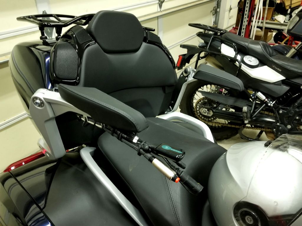

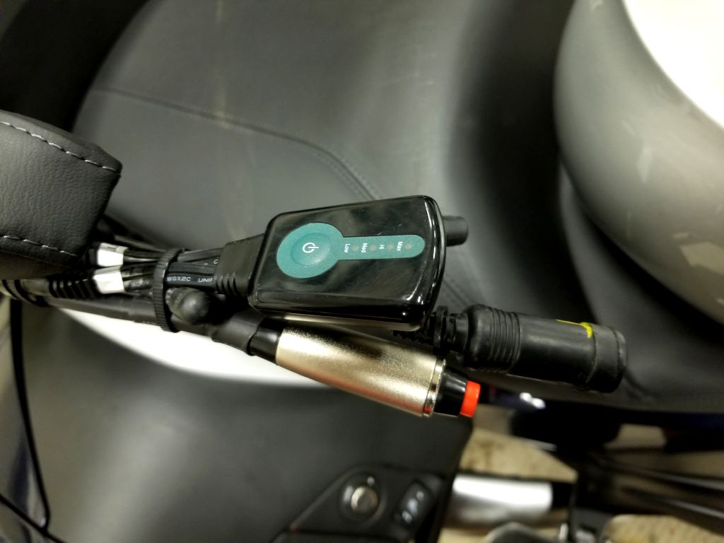

La Reina's (google it) accommodations. Armrests by BMW. On the right armrest is the La Reina control center. Cables for electric jacket and helmet headset (yes, wired). Push button control for electric gear with 3 settings. Push to talk switch. The wires are bundled and tie wrapped around these very large rubber twist ties from Home Depot. Keeps the wire in place but will easily bend out of the way in an emergency.
So, wired audio?? Yep, I do a lot of distance riding and fact is there isn't a bluetooth headset that lasts long enough. Also, the J&M wired helmet speakers sound SOOO much better than the tinny Japanese radio speakers used on all of the bluetooth systems.

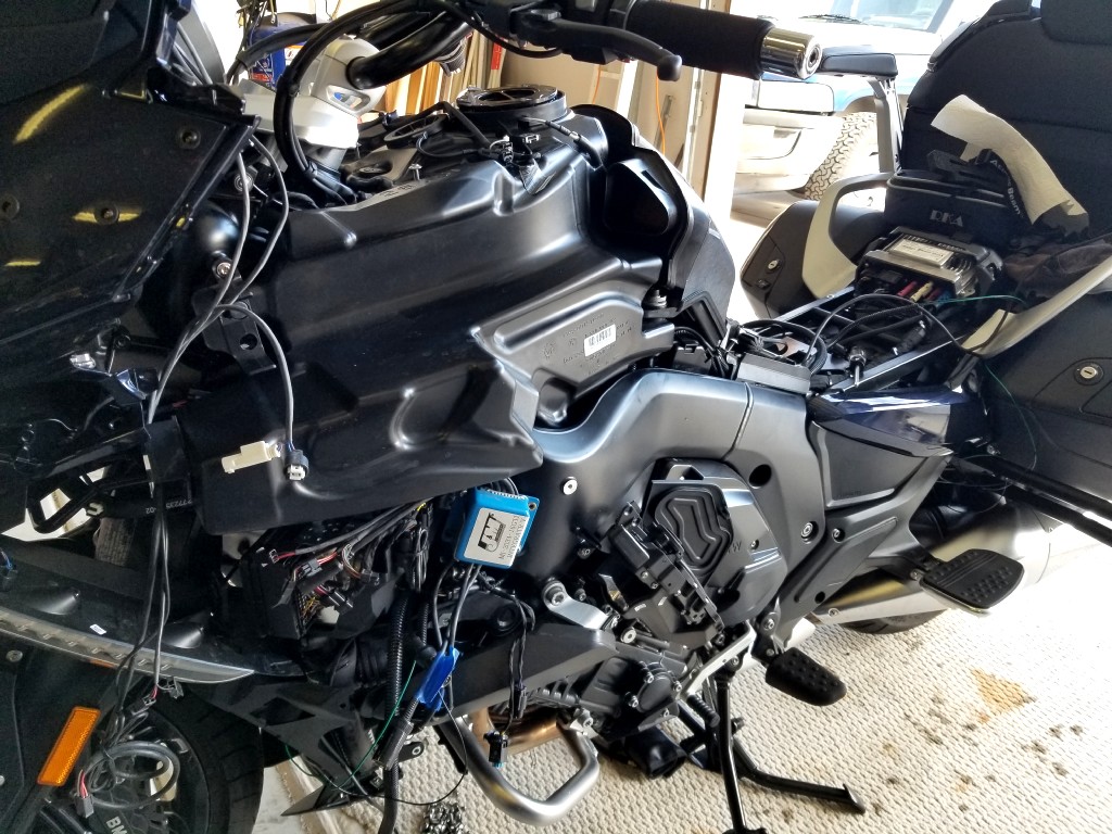

Hardest part is snaking cables around the gas tank and frame and up to the speakers and handlebars.

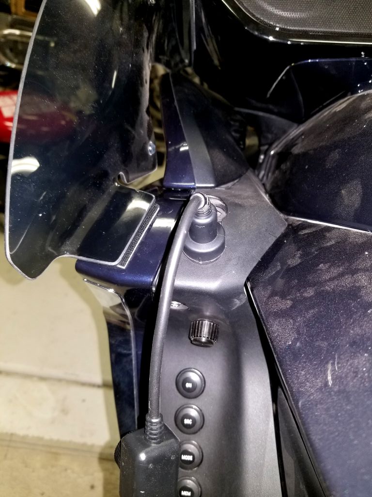

Left side panel gets the rider headset connector and a intercom volume/squelch control.

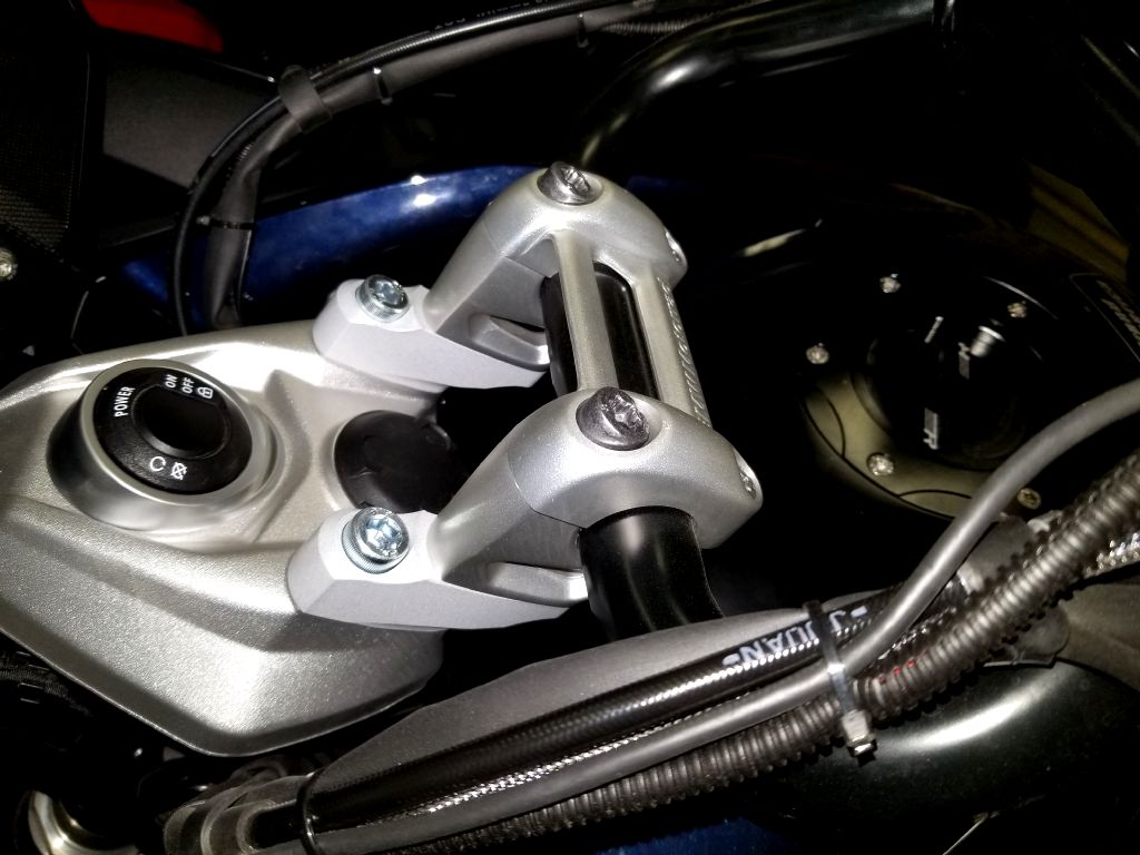

These are the Heli Bars Bar Backs. I originally had the Ilium Works Bar Backs installed. But those wouldn't work with the SW-Motech Micro Tank Bag that I installed. After 2 long trips, I've decided that the Micro Tank Bag isn't for me and I'm going to re-install the Ilium Bar Backs because they look better.

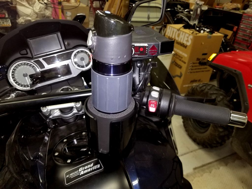

Myself and many other 2012 GT/GTL riders mounted a bicycle water bottle holder on the right side of the fairing facia just over the storage compartment. However, the new design of the fairing, with the bump that curves rearward, means you can't get a water bottle in or out anymore.
So for now, I've installed this ugly Harley/Goldwing water bottle cup holder on the right handlebar. Until I can figure out a better method like maybe an angled bracket that would mount a bottle holder. The Valentine V1 is here also on RAM mounts.

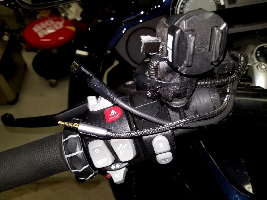

Here's the left side handle bar with the cell phone holder and audio and power cables. Note that the new reverse/fog light button covers up any screws to use for RAM mounts, so I found a RAM mount that uses a hose clamp. BTW, U bolt versions won't work because of the weird size of the handlebar there.
You may have noticed the small plastic flex wire loom going up the RAM mounts. Those are handlebar lights. Thanks to someone (I don't remember) on this forum for the original idea. Some small LED lights that are hot glued into the end of the plastic loom with a little plastic shield also hot glued on.
I installed a HEXezCAN module to control the switched power for everything without having to splice into the BMW wires. The unit has adjustable light controls. I don't have any accessory lights, so I used one of the light circuits to power the LED's. Now they are easily adjustable from the Wonderwheel.

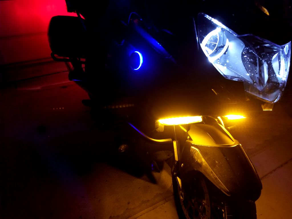

Also on the light front, I installed Clearwater Betsy front amber light conversions and Schrodie Blue/Yellow roundel lights.

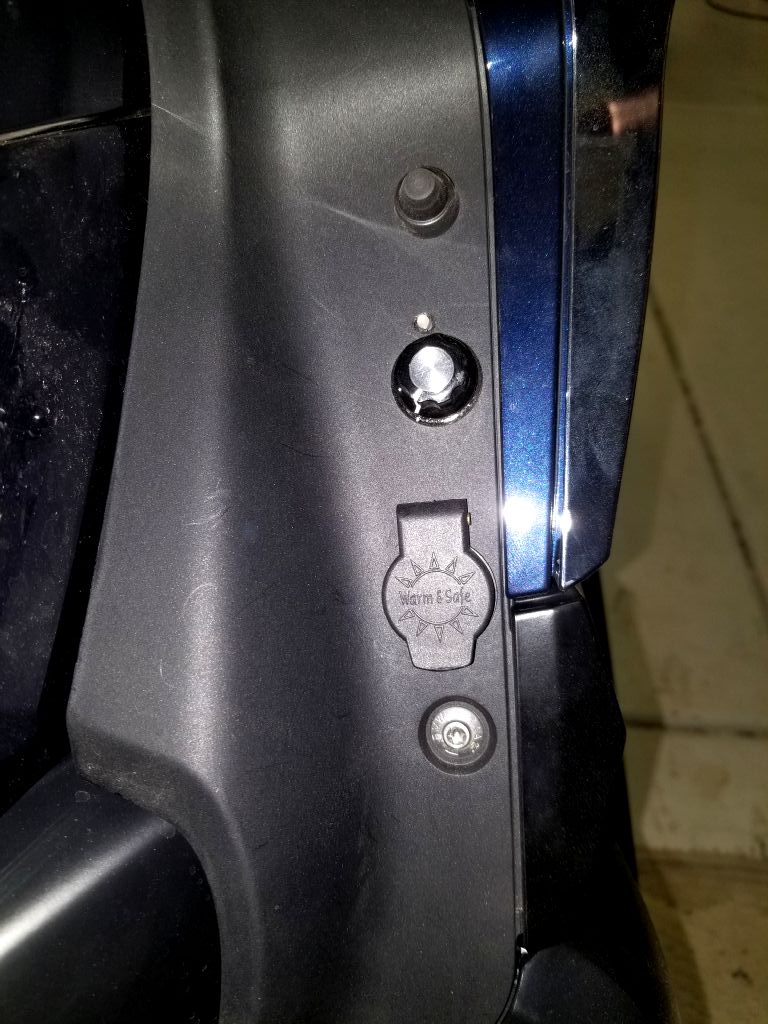

On the right side panel, is the Warm & Safe heated gear controller with the gear power plug below. At the very top is the Mo-Door garage door opener. I used the "Stock Harley" switch type as it is waterproof.
The heated gear, front and rear, the Audio system power, the cell phone power and Betsy and Schrodie lights are all powered by a Fuzeblocks FZ-1 tied directly to the battery (only 1 extra ring terminal for everything). As I mentioned before, the HEXezCAN controls the relay for the FZ-1 switched power.

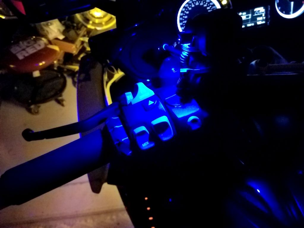

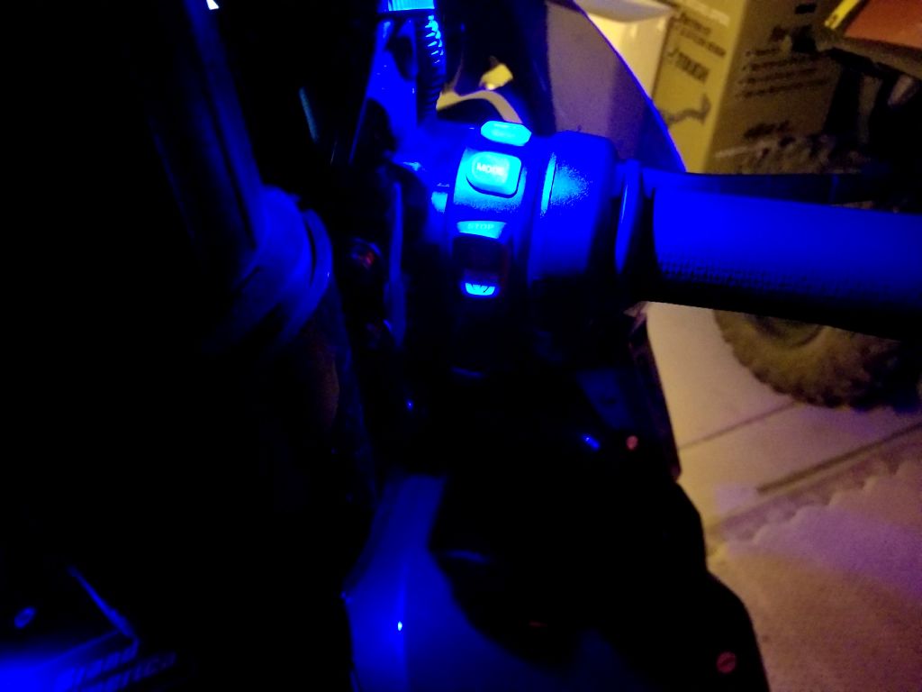

i like your switch group LED idea, i've been wondering why BMW didn't opt to put a back light into the switch groups.
Do you have more detail on how that works? I didn't see any detail about that.

2. Did you notice the ilium works bar backs making much of a difference ergonomically compared to the Helibar bar backs? Or will you put the ilium works bar backs back on purely for the improved looks of it compared to the Helibar bar backs? It appears that the ilium bar backs will move the bars approx. 0.4" closer to the rider than the Helibar bar backs and I was curious if that made much of a difference comfort wise to you.

K16Guy - the lights are from SuperBright LED's.
https://www.superbrightleds.com/moreinfo/high-powered/little-dot-smd-led-accent-light/639/
The description above has all of the info on how I built them and wired them. If you have a more specific question, holler back.

The Ilium bar backs are a smidge more comfortable with the about 1/2" closer. But mostly it's the looks.

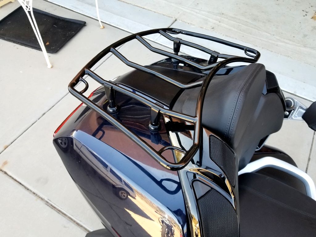

Some have asked for info on mounting the Kuryakyn rack.
Apply blue painter tape. Draw a centerline from the back rest to the center of the roundel on the back of the trunk.
Now, measure 6" on either side of the centerline and draw 2 new PARALLEL lines front to back. The parallel lines are 12" apart.
Measure 1.25" from the edge of the speaker grill trim towards the back. Make 2 marks there on each of the parallel lines. For bikes without rear speakers, the point is parallel with the most rearward point of the backrest vinyl. Mark there and then mark the front to back lines.
The rear posts are 4.5" back from the front posts. Don't go longer than this or the ball/sockets will hit on the curved portion of the rack.
Check everything 1000 times, then drill at the 4 marks.
The top case outer shell is tough enough there that I didn't put any spacers between the outer and inner shells. If you look inside the top case at the inner shell, it looks like there are 4 "pads" that look like BMW intends to make a rack to use those pads for mounting. The holes you will drill for the above are very close to those pads.

Sorry, but I've gotten busy the last few days. I think I can get those measurements tonight. Kuryakyn doesn't provide specific instructions for any bike. I put blue tape down and eyeballed and checked over and over the markings for the drill holes. The nice thing about the rack mounting flexibility with the ball and socket is that the holes can be off by a lot and still work.

So, the Kury rack is super flexible to install. Personally and in retrospect, I would try to mount it using the flat spots on the inside of the case. Look on the inside of the top lid and you will see there are 4 flat circles. Before you drill, measure out the 4 circles and their center points, transfer that to some cardboard and see if the rack will mount into those holes. I'm pretty sure it would, I think the supports may be a little off of vertical, but with the design of the rack that won't matter.
The measurements I provided above make the supports vertical but hit the inside of the lid in not the best positions. I wish now I had done it differently.

As for tips, cover the lid with blue painter tape while doing the install and measuring and especially trial fitting and drilling. Measure twice, go to bed, get up, measure twice again, then maybe drill. Final installation of the rack is a balancing act as everything is so flexible. Tighten the support clamps enough to keep it from falling but still moveable with a bit of force. Don't worry where or how it is lying until you get the clamps tight, then move it around to the right position, then final tighten. It will take some time to arrange it, it's like infinitely adjustable.
