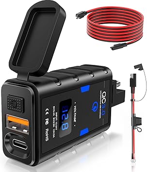

I have this charging port wired up and zip tied to my right handlebar cable bundle (pictured is my previous A port only charging port). It has both the A and C ports with the PD charging system. It has an on/off switch so I have it wired to the battery so that I can charge my Sena while stopped for lunch and still be able to turn it off when parked in the garage for extended periods of time. The one down side to this model is the blue digital display for voltage is very dim, almost unreadable. My bike TFT display shows voltage so I really don't need that blue display.

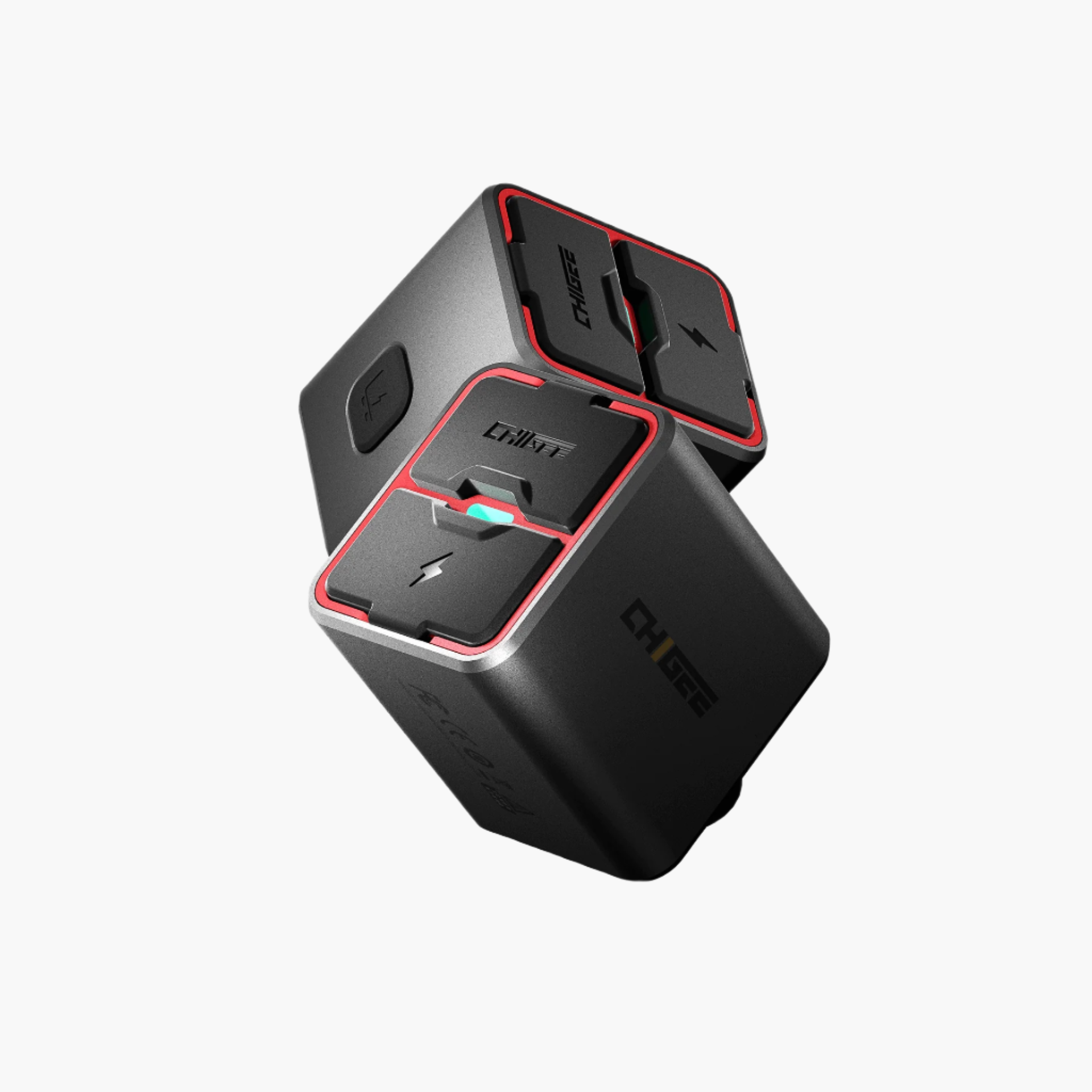

I use the Quadlock Mount with the Wireless Charging head for my iPhone 15 Max Pro. I like the anti-vibration setup on the Quadlock as I don't want to destry the sensitive camera in the Phone.
To provide power to the Quadlock Wireless Charge, I have just installed the Chigee TR100 Two-Way Charging Hub.
This 100W hub provides two outlets; USB-A and USB-C and can be used with either lead acid or lithium batteries. What sets it apart is that it can be used as an emergency charger if you have a dead battery. You just set it to reverse charge and then plug a USB power bank into the USB-C port.

I went ahead and purchased the USB charger @Arizona Jim referenced in post #33. I went out for a test ride this morning, and it works as advertised. I was surprised at how fast the phone charged up while running MRA phone navigation and Apple Music.
So, I'm keeping the Peak Design Qi2 mount charger. I'm a big fan of the Peak Design mounts, and really didn't want to try a different brand. All is good. (y)
