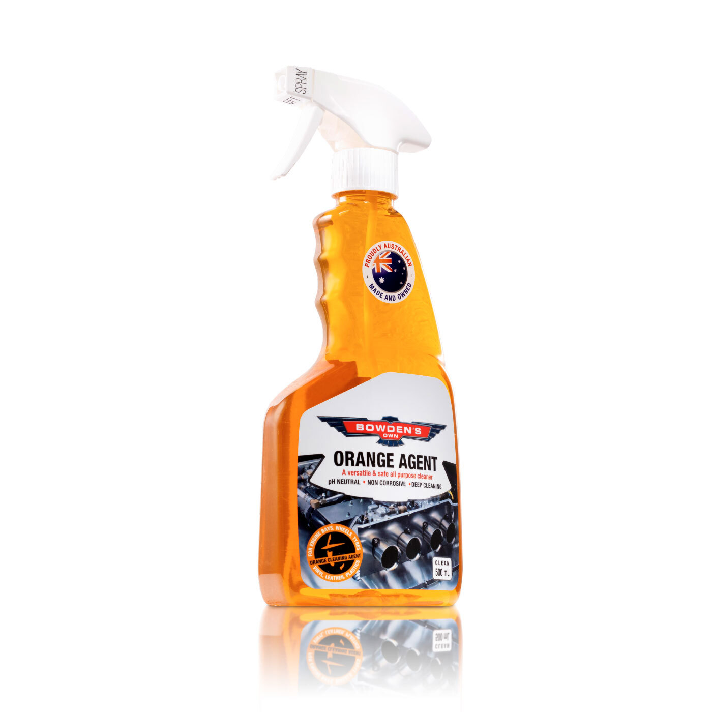

I remove the stone guard but not the radiator, just give it a good spray and soak in a mild solvent, I use Bowdens own Agent orange, and then give it a good hose out, if I use a pressure washer I stand well back or turn it down if possible, let the water run till theres no more soapy Residue coming out, and then hose it a bit more
I done It a couple of times now, definitely see a drop in temps and fan cycles, taking the radiator out would be better, but is a lot more work.
Wow, Troy, there is no way I could use something that was used in war, agent orange stuff was so bad. No disrespect to those who served in that bloody war but the poor buggers went through **** and back on both sides and all because of chemicals.:whistle: I go with sugar soap as my fav or mild dishwashing liquid does the same thing when it comes to cleaning out crap.
@Geoff_3 you’re jumping the gun a bit here.
It’s a cleaning product, pH neutral citrus based. Nothing to do with Agent Orange/2.4.5T which deformed my nephew, born post VN.
· Upside Down
Joined
4,404 Posts
Heli I know I have seen it at Super Cheap but thought it was the perfect time to stir poor Troy a little lol. I know I live in NSW but I do have a broad sense of cleaning products lol. :whistle::unsure::D:p:ROFLMAO::rolleyes: As for your nephew, I am sorry to hear that about him..
