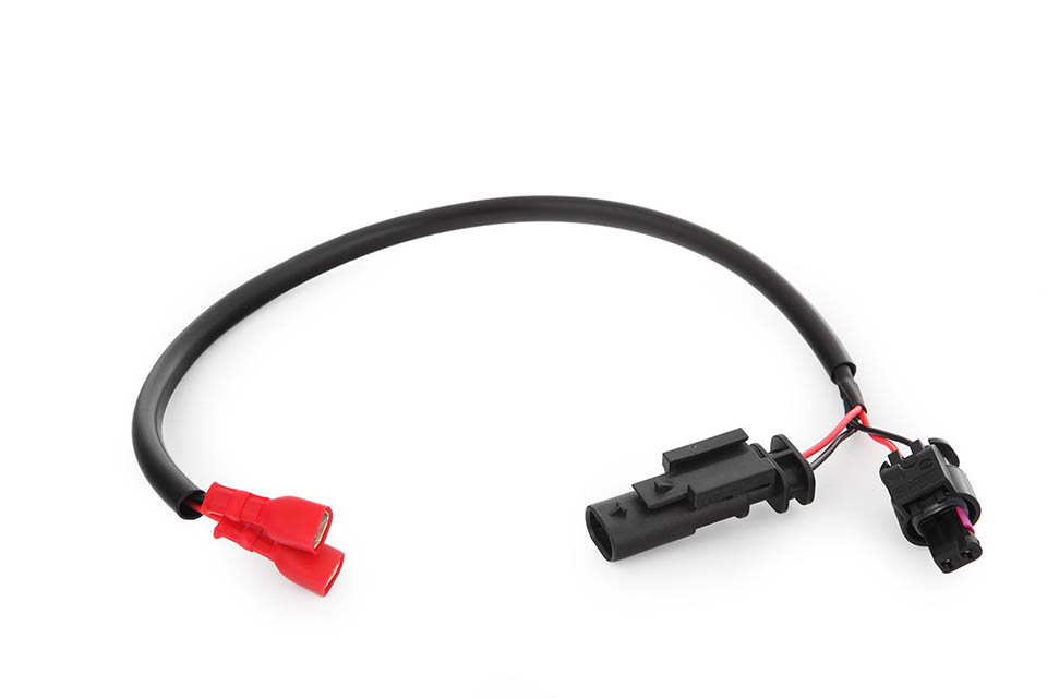

I believe this is accurate but am open to correction...my powerlet stays "hot" after shutdown, but not indefinitely; it times out. I want to say at about a minute (unless there is a load as discussed). I didn't know if you were testing power there within that time period, seeing power, but not testing after the time has expired, and assumed the power was on indefinitely. Just a suggestion.
#23 ·
I have this Wunderlich connector on my GT, powering a GPS. It works as described, the power stays on for about a minute then shuts down. It works. If the GPS battery is 100% loaded, there is no load on the circuit at shut down and the canbus shuts it down immediately. If the GPS battery is 99% charged and still needs a little bit, the canbus sees the load and will leave it on for about a minute.
For all intent and purposes, it works like old style switched circuit, it shuts off when the bike shuts off. It’s just a little confusing that it doesn’t happen immediately. Maybe that’s the Germans playing with us🙂
