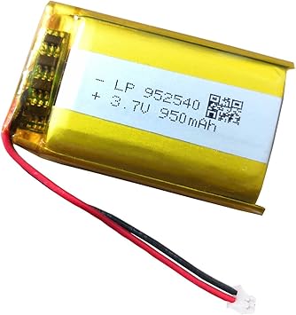

REVISED 8-31-2022 If you are like many of us with the Sena 50S you've encountered the battery not lasting more than 2-3 hours. One of my 50S is out of warranty and the battery only lasted a couple of hours. Sometimes Carolyn would get a low battery warning within 15-20 minutes of turning it on. @6xGrins had recently done a battery change on his 50S with good results. After talking with him I tackled this little project.; e.g. the pins that go into the bottom connector are at a right angle making it difficult to disconnect. Changing the battery is the easiest part. I tried to reinstall the circuit board and could NOT get the pins to align with the bottom connector. After a bit I gave up and resorted to YouTube. I found one video that was helpful. In video, option 2 is the hot ticket. Start by applying a little heat to the bottom of the 50S where the pin connector is located. I used a heat gun. Then using an X-acto knife, pry the connector from the housing exposing the pins to the circuit board. After removing the little screws on the back side and prying the thumb wheel off I then pried the circuit board up to get access to the battery. There are 7 screws holding the housing together. 2 of the screws are smaller than the other 5. 1 of the screws is almost hidden.The circuit board is plugged into the 50S housing at 2 spots; both located on the far right hand side, I used a screwdriver to gently pry the circuit board straight up. With the circuit board out of the way, using a small set of needle nose pliers I removed/replaced the battery. Once this was done I reassembled in opposite order. FWIW, There is a sticking substance on the backside of the pin connector that is tacky so I'm comfortable the connector is sealed.

Update: I just did a search and found a 950 mAh battery listed on Amazon for the 50S. I ordered one and if it fits I'll update the link for the battery.
Duane
Discussion starter · #7 ·
Update 8-3-2022 I received and installed the 950 mAh battery from Amazon. No issue with fitment. I have revised my initial post to reflect what I did to change the battery. All information in the first post is accurate. If you try this and run into a stumbling block send me a message (conversation) with your phone number and I'll give you a call. Even better if you have an iPhone; FaceTime ..

@Ron Coleman , the battery I replaced was in wife's 50S. Since changing we've done 2/3 6-8 days, mesh only, no "low battery" reports...
"If" I changed battery again I wouldn't use the 950 mAh. I recently see that Amazon shows an 1150 mAh battery; I'd go with that one.
